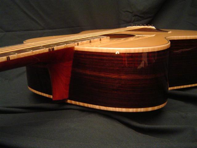

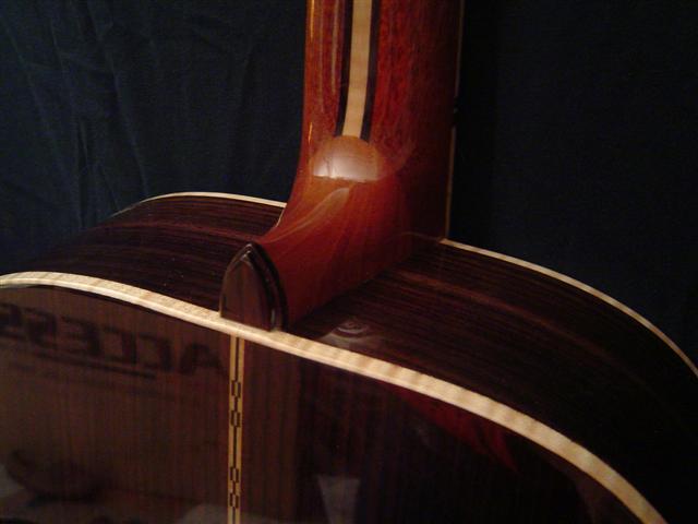

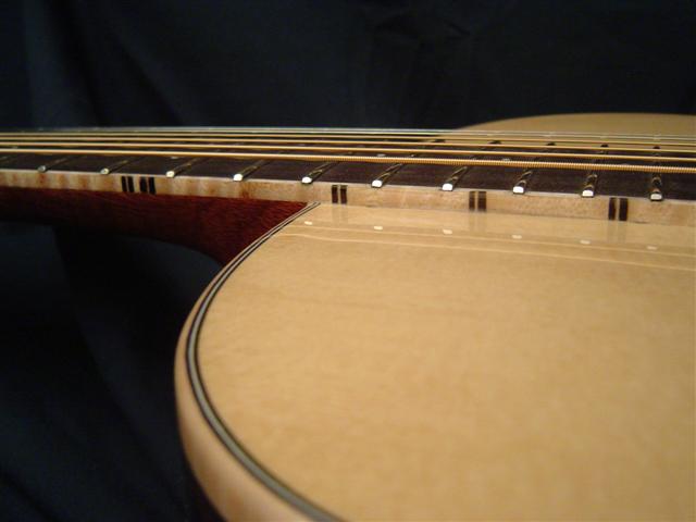

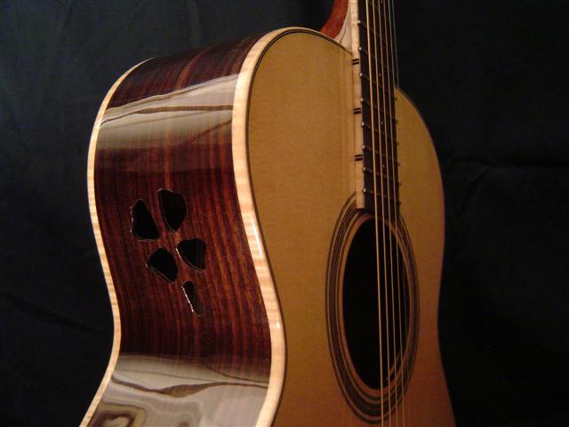

Here are some shots of the steel string built in my class from this semester. It was built from an LMI kit. The side fret markers are inlaid ebony and maple. Bindings are flame maple, Sitka Spruce top and EIR back and sides and Ebony fretboard and bridge. The neck is mahogany laminated with maple and EIR
The finish is catalyzed urethane.

and....I like that soundport! Did I say that before already? peterm39073.9467361111

Wow, what a finish. Cool frets too. Keep up the great work.Dickey39073.954525463

Very nice -- love the 4 leaf clover!

Really nice Robbie. Love the finish and the woods. The binding looks seemless.

What are those fret markers on the side of the fretboard. I love the idea. Inlay??

Excellent craftmanship and very nice looking guitar Robbie, Love the idea for the ebony fret markers!

I like your soundports too. Very classy.

Thanks everyone for the compliments everyone. The story behind those fret markers is interesting. I at first installed round ebony dots but wasn't happy with the results. Me thinks to meself...this is an opportunity to be creative! So, I removed the round ebony dots and inlaid a piece of square ebony in the binding. It was a bit too much ebony for my tastes so I decided to break it up a bit. I then inlaid a piece of maple purfling in the middle of the ebony and that made it acceptable again. I would love to say that I thought up this design and set out to execute it but it just kind of evolved into what you see. Anyone ever had that happen?
